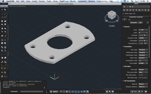

Well I met up with Ariel, ( thanks bud ) and we are going to work out a brake booster delete plate for my ITR. Since I use to be a AutoCad nut, I thought I'd draw up something to get started till the Willwood Master Cylinder gets in. Pretty basic for now till I can edit it and add the parts for the MC to bolt up on to.
PostSubject: Re: 2010 ITR build thread!! UPDATE 2.25.11   Sun Oct 31, 2010 10:12 pm
Little more work, put in correct hole diameter and countersunk.

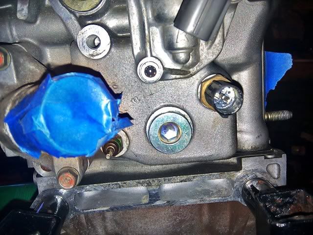

First was to plug the fitting that went to the engine for the heater. and to weld/plug the h2o neck ( big thanks to Cletus with Boss and Sons for welding that up for me, pic will be up soon)
What I'm replacing.
Old.
New.
Then I started redoing parts for my motor. I did the thermostat housing and h2o neck, distributor, ect.

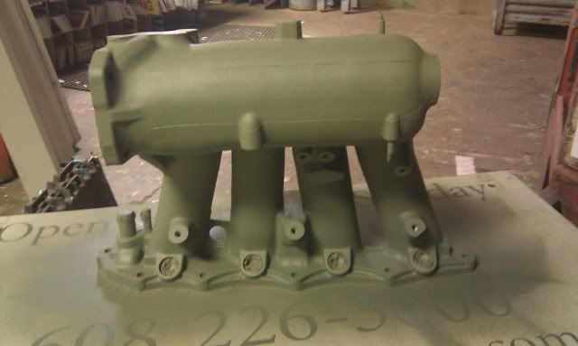

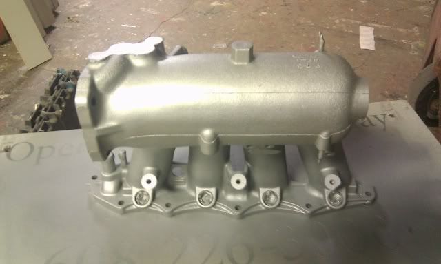

Here is the mani.
Clean and degreased and recleaned. Then I put a coat of self etching primer on.
Then several light coats of high temp paint, then clear.
Looks factory new.

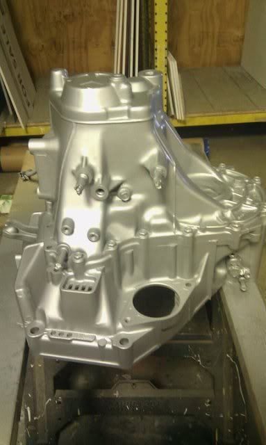

Started on the trans at work today instead of 'working'
Cleaned it all down with brake Clean, then with steal wool then brake clean, then sprayed it down with water acohol mixture and wiped dry. Only took pics of when I just started.
Taped up where I didn't want to paint.  Then primed it up with self etching primer of course.  Here it is after a few coats.
Then painted on light coats of paint.
I will let it dry for a day or two then go back and clear it all.
