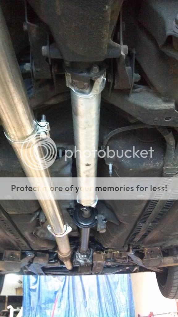

Drive shaft installed.
STiedVR4Guy's VR-4 Build Thread - Page 5 2012-05-08_10-41-16_4
STiedVR4Guy's VR-4 Build Thread - Page 5 Empty
PostSubject: Re: STiedVR4Guy's VR-4 Build Thread   STiedVR4Guy's VR-4 Build Thread - Page 5 Icon_minitimeThu May 10, 2012 3:30 pm
No one makes a one piece?
PostSubject: Re: STiedVR4Guy's VR-4 Build Thread   STiedVR4Guy's VR-4 Build Thread - Page 5 Icon_minitimeThu May 10, 2012 3:40 pm
Did you notice a difference?
PostSubject: Re: STiedVR4Guy's VR-4 Build Thread   STiedVR4Guy's VR-4 Build Thread - Page 5 Icon_minitimeThu May 10, 2012 4:08 pm
There are a few but because of the angle of the rear diff and transfer case it is recommended to go with a 2 piece if you still drive it on the street. I found this one for $600 and most of the 1 piece ones are carbon fiber and $1000+ used.
It feels a little smoother. I have not had it past 110 so I am not sure if there is any vibration yet. I might have to add a few washers to the studs where the carrier bearing is so it will be a little more level. But for now it feels a lot smoother during acceleration and shifting. Less slop I guess? Not a night and day change though.
Once I get the steering rack thing fixed and have it aligned again I will see if there is any vibration then.

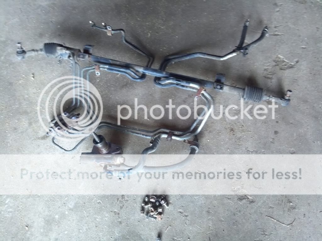

Got some work done on the car this weekend.
AWS delete:
Out of the car
STiedVR4Guy's VR-4 Build Thread - Page 5 2013-05-25_13-42-54_979_zps978888c5
All the stuff
STiedVR4Guy's VR-4 Build Thread - Page 5 2013-05-25_13-43-21_209_zpsdedd3f0d
No more stuff, locked in with arms, and plug the hole in the diff
STiedVR4Guy's VR-4 Build Thread - Page 5 2013-05-25_16-55-14_321_zps0dea5b7b
Minus 30 lbs!
STiedVR4Guy's VR-4 Build Thread - Page 5 2013-05-26_12-22-30_46_zps484800ca
Supposedly this was listed as a 14 hour job to just do the AWS delete. Clearly they are fucking noobs because it took us 8 with time out to go cook some food for lunch and sit down to eat.
I managed to balance that whole thing on the jack, lower it out of the car, work on it, and put it back without falling off.

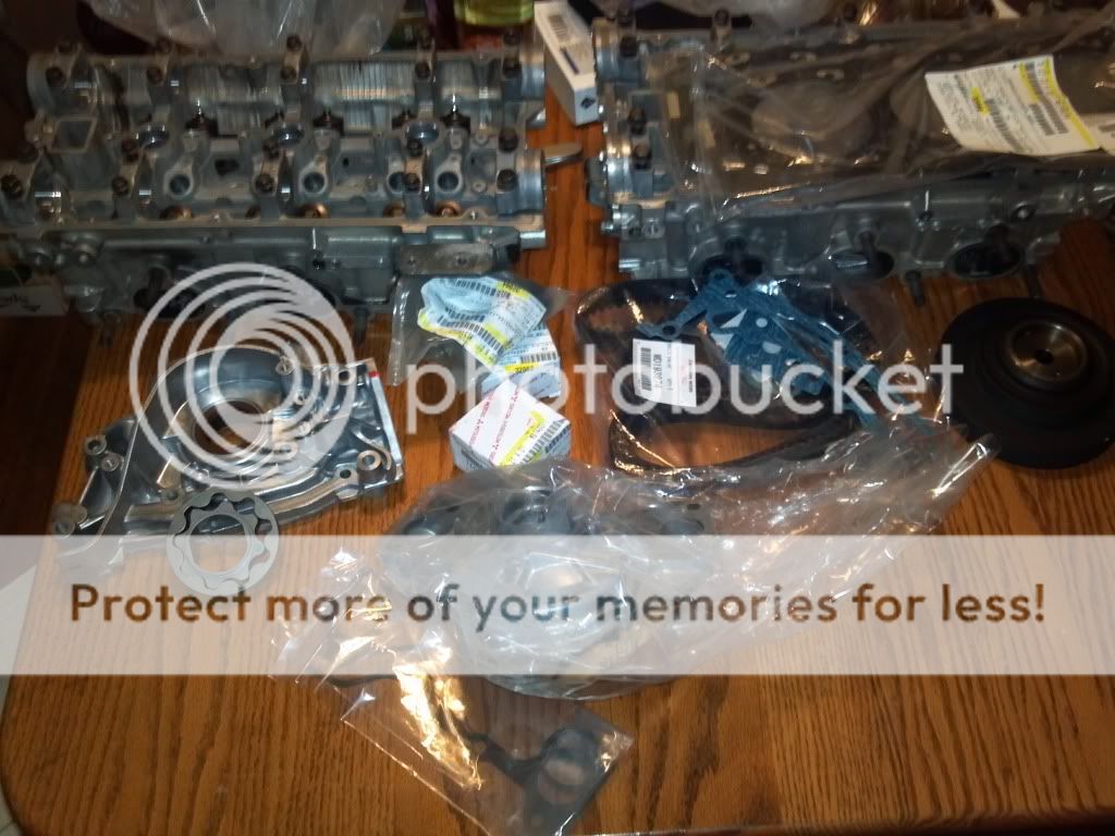

PostSubject: Re: STiedVR4Guy's VR-4 Build Thread   STiedVR4Guy's VR-4 Build Thread - Page 5 Icon_minitimeThu Aug 01, 2013 5:40 pm
Got some stuff in:
STiedVR4Guy's VR-4 Build Thread - Page 5 2013-07-31_12-06-36_652_zpsecbdbd25
$450 oil pump gear upgrade:
STiedVR4Guy's VR-4 Build Thread - Page 5 2013-08-01_16-07-53_367_zps1eb3b4d2
