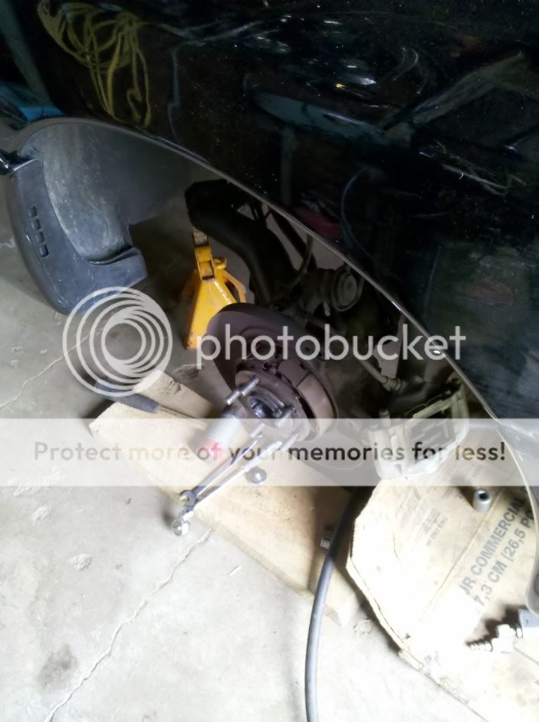

So I got some work done on the car Friday. Not everything I planned but thats never how it goes....
So first off: Stuffss
STiedVR4Guy's VR-4 Build Thread - Page 2 IMG_20110527_103952
First project, replace rear wheel bearing because its completely shot and vibrates like crazy.
STiedVR4Guy's VR-4 Build Thread - Page 2 IMG_20110527_103947
Inside housing: I was told I would likely need a hub puller for this, luckily my dad happened to have 5 different versions of a hub puller of varying size and shape... Why? idk.
STiedVR4Guy's VR-4 Build Thread - Page 2 IMG_20110527_104607
Ended up getting the hub out after some nervous hammering. On the left is what it is supposed to look like, and the right is the completely fucked one.

The outer bearing had actually worn down the part where it is pressed on and came off when we hammered it out of the trailing arm housing. The part that had my dad worried was the housing. On this car the trailing arm and rear hub housing is one big piece and there is an inner bearing that is pressed into it. If that piece was messed up (luckily it wasn't) I would have to get the inner bearing and get it pressed in there or a whole new trailing arm which is $450 for one of these. Luckily... none of that happened.
Ended up calling a shop before hand to see if there was some trick to getting the axle out other than just using a steel hammer and beating the shit out of it. Nope...

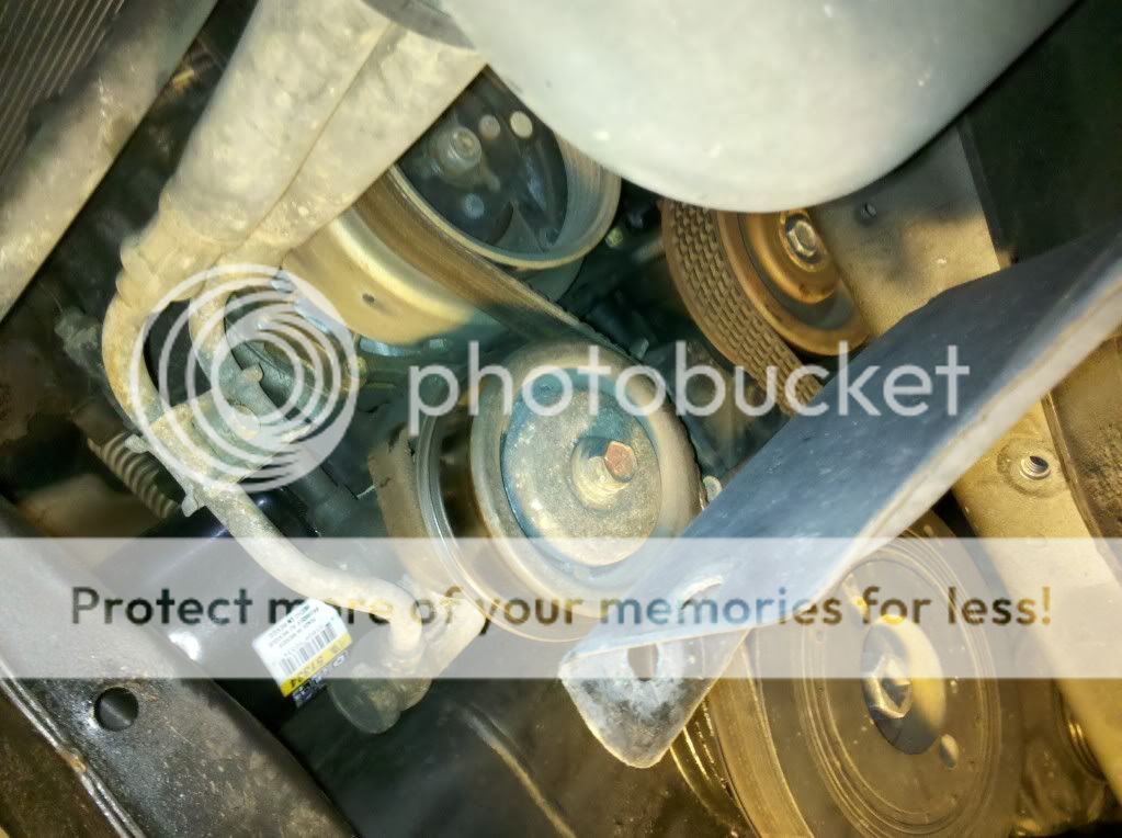

Update:
Did the AC delete on my car Saturday.
Radiator removed
STiedVR4Guy's VR-4 Build Thread - Page 2 IMG_20110611_125159
STiedVR4Guy's VR-4 Build Thread - Page 2 IMG_20110611_125241
AC compressor and OE belt setup
STiedVR4Guy's VR-4 Build Thread - Page 2 IMG_20110611_125411
Compressor off the car
STiedVR4Guy's VR-4 Build Thread - Page 2 IMG_20110611_144751
Modified tension-er bracket with new pulley installed
STiedVR4Guy's VR-4 Build Thread - Page 2 IMG_20110611_144826
Installed on car
STiedVR4Guy's VR-4 Build Thread - Page 2 IMG_20110611_175728
Removed stuffs
STiedVR4Guy's VR-4 Build Thread - Page 2 IMG_20110611_183107
Everything went rather smoothly until we got to the belt. The one that was sent to me was to short and wouldn't work. We tried removing the 2 pulley's that just make things loop around other things and the belt would have been rubbing on a bracket (no good).
2nd idea was to try and put that pulley back on to go around but then the belt was to short with the tensioner using all of the modified bracket although it was VERY close.
We guestimated that we needed a belt 2-3 inches shorter and it would work just fine. Went to town got one and it did.
Also removed the charcoal canister as it's just for emissions.
Total removed weight = roughly 40 lbs
Afterwards I drove into town went to see a movie car was fine. Drove all the way through downtown and then left stevens point headed for madison. Got 70 miles everything seemed normal. Stopped at a rest stop and noticed that there was steam coming from my hood.... Checked the temp gauge, looked fine. Ok checked under the hood and there was coolant blown everywhere. Both overflow tank and the filler cap were on securely. Checked all the hoses couldn't really fine anywhere it could be coming from.
HMMMM. I was worried but it was still running normal temp, coolant levels were fine, so I just decided I would try to limp it back to SP as I was only about 20 miles out.
No go, got about 10 miles away from the rest stop and saw the temp gauge start to climb. pulled over and called a flatbed. Got it towed back to my appt and put in the garage.
Looking at it after getting it back off the tow truck, the driver pointed out. Your fan is unplugged..... WHOOPS.
I think I caught it in time, I can't see anything else I forgot to connect sooo I think I can just refill with coolant and make sure to "burp" it and get all the air out. Overflow reservoir is full up to the top (which it wasn't) so I'm pretty sure there is air in the system.
I didn't hear anything from it but I hope I didn't fuck up the water pump :/ Although the 180K service is coming up here so it will get replaced soon anyways. I don't think I did any damage.
to be continued...

Mishimoto, it was cheap and I needed something quick Smile
I ended up not using some of the bushings that came in my kit to set in the holes it sits in on the bottom so its not metal on metal. It can't really move the way I have it right now.
Going to have someone take a look at the stock brackets and see if the can modify them to fit.

So did a little more work on my car this Sunday.
Got the front stainless steel brake lines installed and new rotors. Now some of you may recall I have warped several sets of rotors on this car... So recently it came to mind the little plastic rings that came with the aftermarket wheels on my STi (known as hub centric rings).
So after someone bringing it up on another forum I realized I don't have those on my VR-4 wheels.... Fuck.
So I went over to discount tire and ask them about it, they have the exact ones I need in stock. If this fixes the problem I will have wasted so much money diagnosing this problem when the issue was a set of $15 plastic rings. God damn it.
anyways.... Brakes feel much stronger Very Happy
