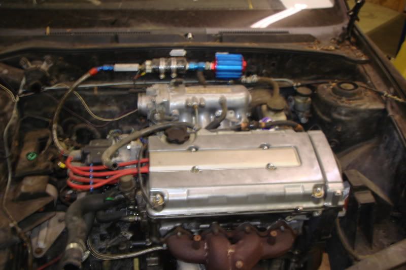

wasnt much to look at after sitting so long but did ok on the dyno/after both front brakes started on fire and some minimal tuning. heres a pic of what it did look like under the hood. i didnt take any other pics since it was just a basic Hyundai with konig tantrum 17" wheels.

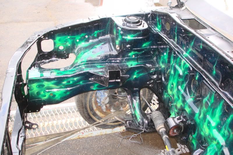

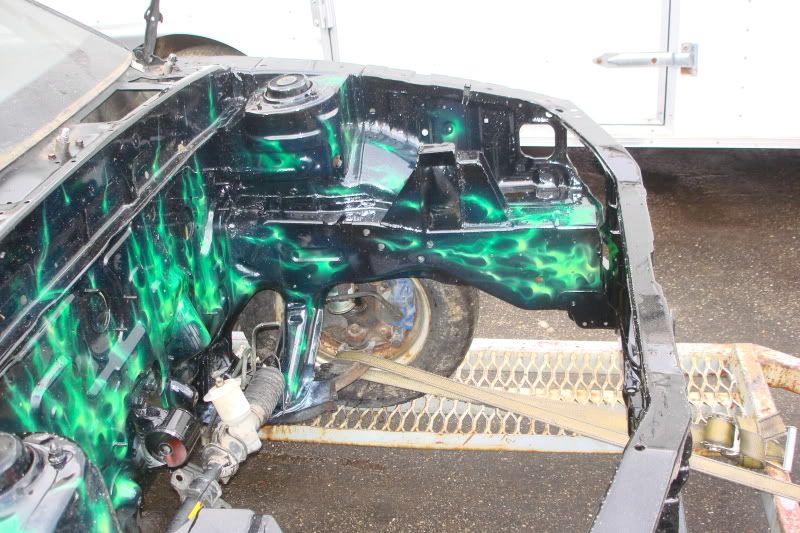

that was @ a week ago, dropped that out and stripped the car. dropped the car at willy's last week & he sprayed the jambs & under hood a dark charcoal with the flake in the clear. Mat wanted something else so willy did some green true flame too. picked it up from the body shop this morning to re hang the motor & get started on the exhaust.
looks a lil funky from being hauled on an open trailer behind a dually with no mudflaps in the rain/ill snap some better pics when i get it unloaded & wiped down
