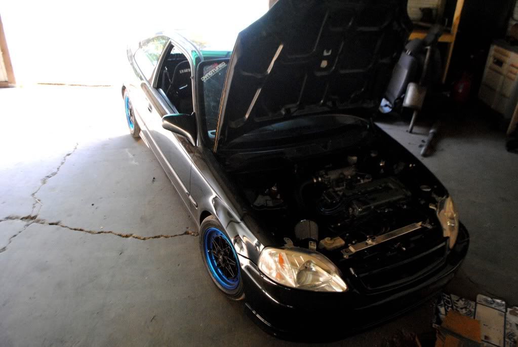

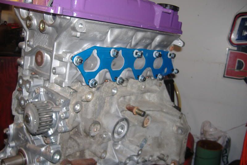

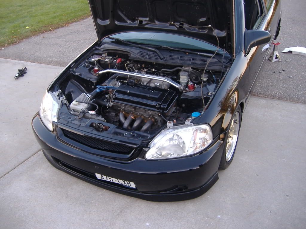

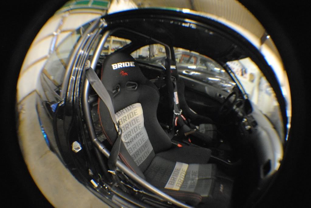

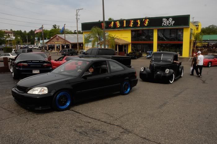

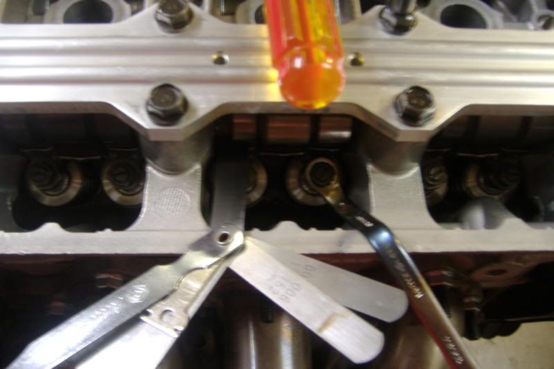

| My name is Ryan and this is my 1997 coupe(was my first car). It all started with me asking Bryan Johnson to "vtec" my stock single cam at age 16. After his harsh answer i decided to hit the books and look up what was "cool" to do with a honda so not long after i called him asking to show me how to do a b series swap(LS). Made many new friends and got into the addicting habit of building cars. *****This build thread is one from last year, new plans over the winter so i will be updating with pictures**** -does not have the flashback wheels anymore -slappin a turbo kit on GENERAL INFO *innovative mounts with stiff bushings(no marshmellow bushings) *all mounts and brackets were powdercoated black * si front end and bumper *Pioneer Deck *Custom clutch line that runes behind the firewall, through the frame and to the slave cyl. *Tucked brake lines(all mounted and riveted) kept heat -chasebays coated brakelines with A/N fittings -willwood master with a booster delete plate(stiff pedal, stops great) -Integra prop valve *integra brakes all the way around *new pads, rotors (anything brake related has pretty much been replaced) SUSPENSION *Koni Yellow/Ground Control (bought new, great condition) *Rota flashbacks Falken 912 tires *Extended top hats *ASR subframe brace(black) *function 7 black lca's *ASR swaybar *blox camber/toe kits(everything) *new wheel bearings *extended studs *buddyclub lugnuts _A lot of suspension and brake work has been replaced and upgraded, handles amazing_ MOTOR 208hp 150tq GSR "stroker" ( power peaks at 7700 rpm because of compression and cam combo) *E85 *B18c1 (81.5 mm) *type R trans(LSD) *ls crank *Eagle rods with upgraded bolts *mahle 10.5.1 pistons *all new waterpump,timingbelt,oilpump,gaskets, etc. *supertech springs *supertech retainers *supertech keepers *supertech valve seals *supertech flat face high compression valves *skunk2pro2 cams *precision 580cc injectors *new oem headgasket *ARP headstuds *blackworks full size aluminum radiator *samco radiator hoses *STR adjustable cam gears/cam cap *Blox intake manifold(port matched to throttle body) *Omni 70mm Throttle boddy *aluminum catch can with black braided lines and fittings *kiddracing replica header(2 1/2 inch collector) *full stainless tig welded custom 3” exhaust all the way to the rear bumper with a turndown.(exhaust built for boost so it is loud now) INTERIOR *Bride seats (black with gradation) Replicas but are very nice *G FORCE 5 pt harnesses with twist lock *dash/carpet/doorpanels and all plastics are black *Tucked fuse box(NO AIRBAGS, fusebox is in the airbag location) *Battery relocation *CTR cluster(amber) *Rollbar *nrg quick release *nrg hub *nardi suede replica wheel Pictures aren't really in the order of oldest to newest or anything (the bumper with holes is no longer on the car, it has a new si bumper) *a few motor build pictures from previous cams* now for some that are a little older | |

| thats the cleanest honda/import ive seen in long ass awhile. that was at my 10th anniv. show 2 septembers ago i think? i was impressed, still have that crappy trophy? | |

john's son?? sold the blue wheels since they were the only "flashy" things on the car. | |
