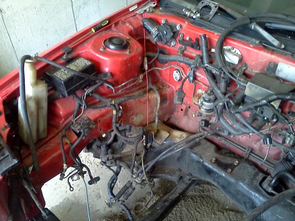

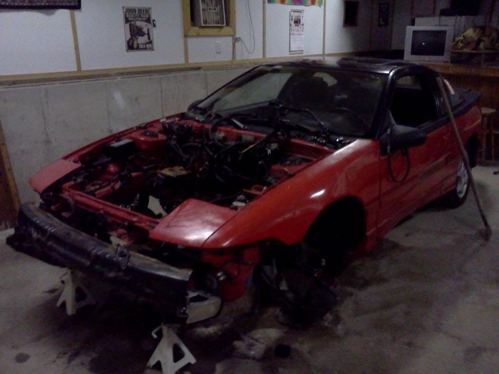

So im starting fresh on the talon. Im in no hurry to get it done i just want exactly the way i want it this time. I sold the motor, trans, transfer case. and ecu to a kid from the cities. When we dropped the pan we found out the dumbass that wrecked my car also managed to do enough damage to spin a rod bearing on the number 1 cylinder. The kid decided he wanted it all anyways so he would have parts to start his 6 bolt swap on his 2g. As of now im starting to work on the body. i started cleaning out unnessacary things in the engine bay so i can clean it and make it look brand new again. Heres my progress as of the last couple hours, should get farther this afternoon. Im trying to prepare it so i can fix the rust and get her the long deserved respray.

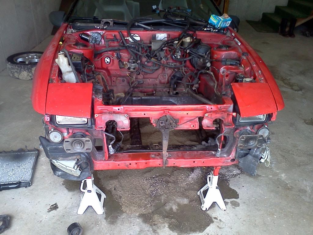

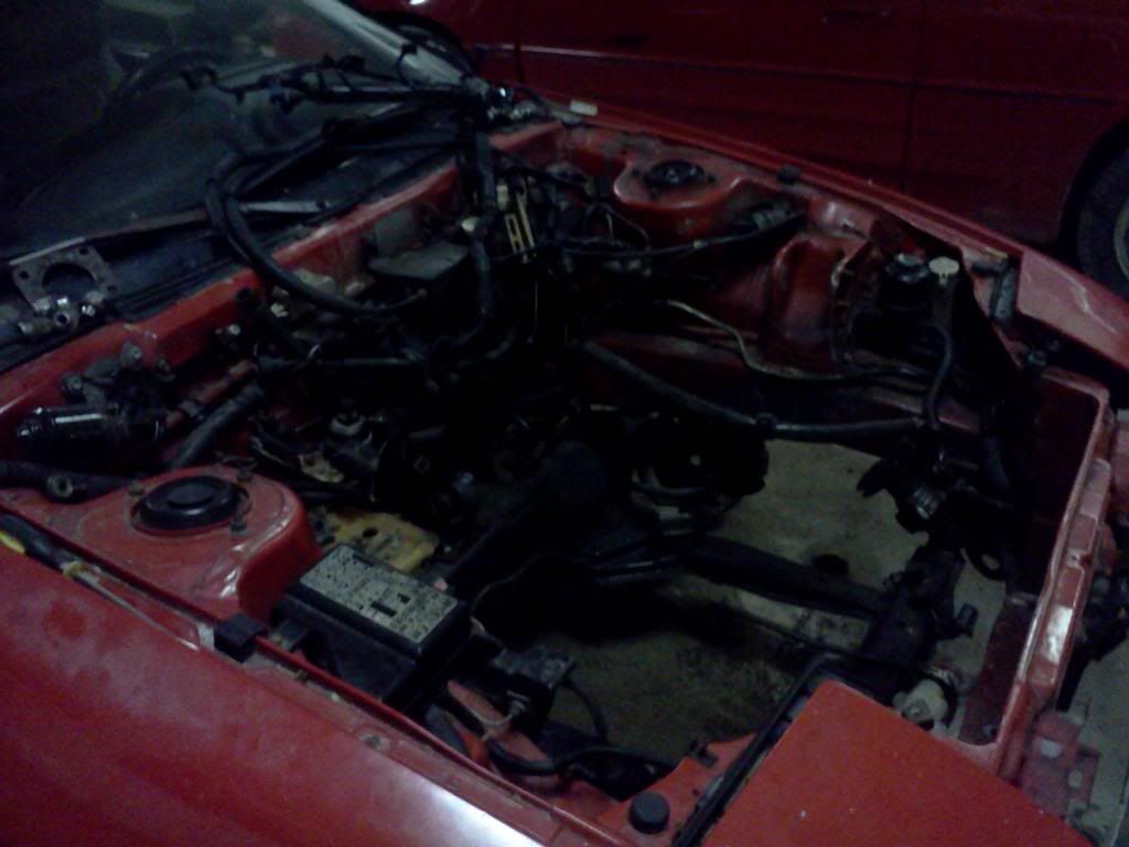

my progress so far today
I have most of the engine bay empty, i know i can remove a few more things emissions wise but im still reading up on it.
I also removed the front bumper support so i can get the smaller one to make room for the fmic
