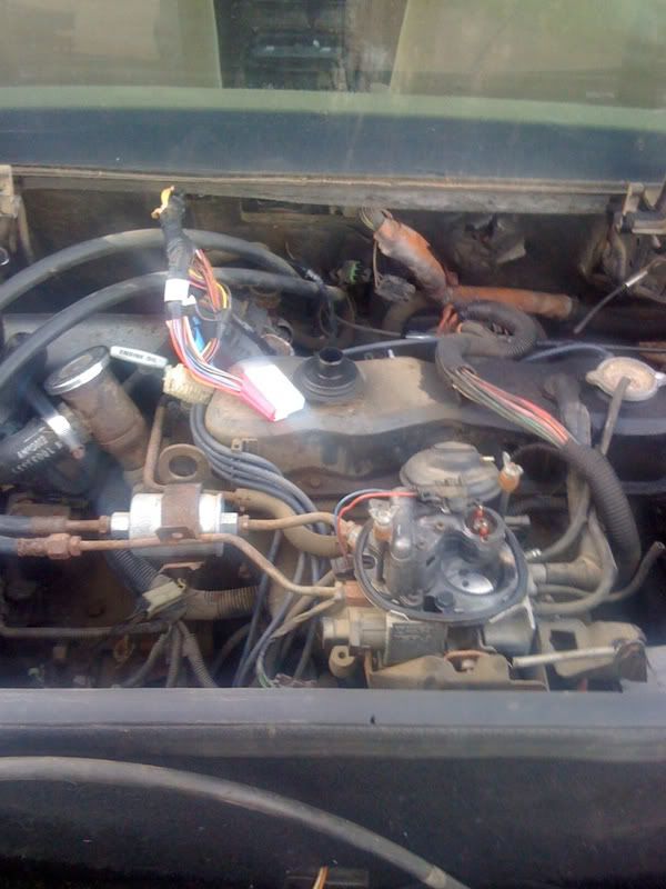

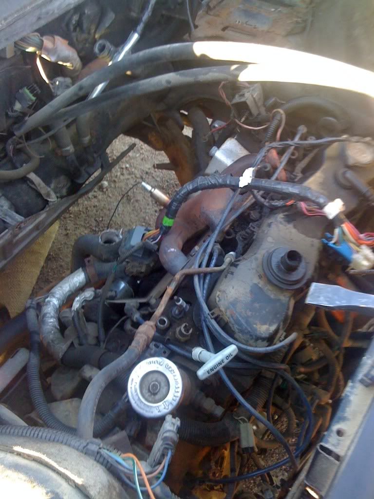

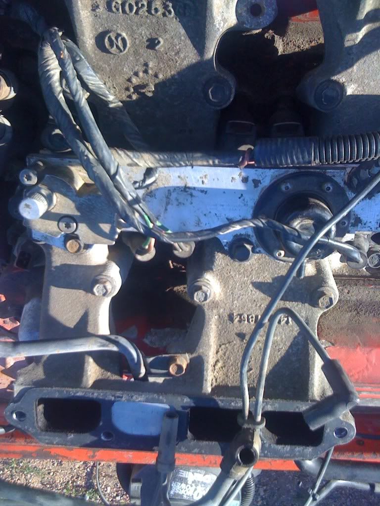

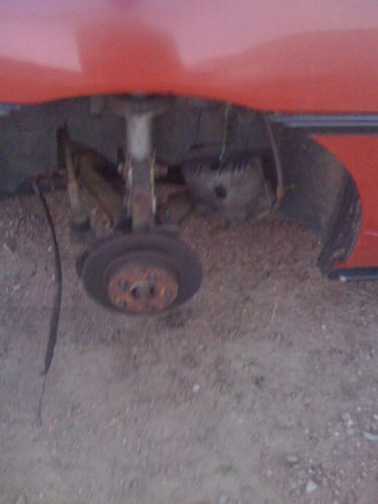

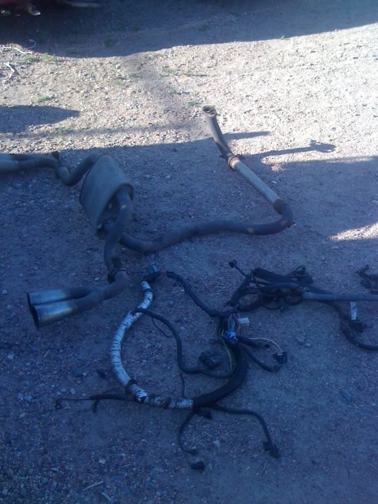

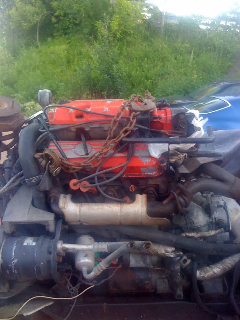

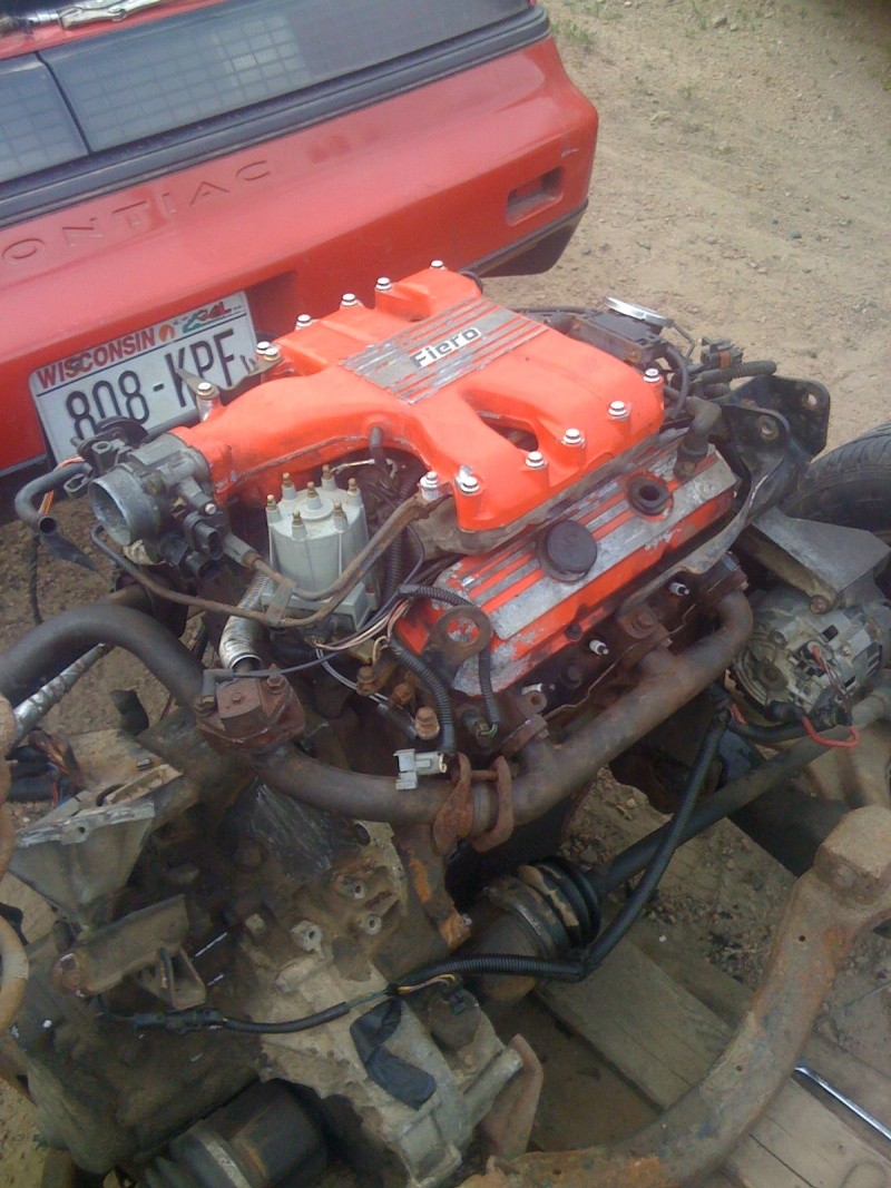

So other then pictures i'll just tell you what i all had to and have to do. First thing first is find a donor 2.8 V6 out of a fiero. After i did that i got the Fiero to my work place, and started disconnect everything and drop the cradle. Ran into a couple problems but everyone who drops a fiero cradle has some sort of problem. After dropping the cradle you then have to take the engine off the cradle, pretty simple have two cradle mounts and the bell housing bolts then its off. Then its time to prep the other motor, you have to take the top plenum off so you can get to the fuel rail to remove the fuel lines. Then because the donor V6 i picked up had an Automatic harness i had to completely strip that off, and replace it with a manual engine harness. Once the engine harness is on, i proceeded to put the V6 fuel lines on and a newer fuel rail. Then you can put the plenum back on. The 4 cylinder and 6 cylinder have different Flywheels so luckily i had a spare laying around. The clutch and pressure plate are the same tho. The transmission spline is relatively short so it makes it a hell of a lot easier to connect the engine.
Thanks everyone yeah should be up in running by tomorrow. I'm doing this pretty cheap so thats why i'm trying to go as fast as i can lol, and its my buddy's daily driver

Just uploaded the video i made, sound quality is pretty bad.
