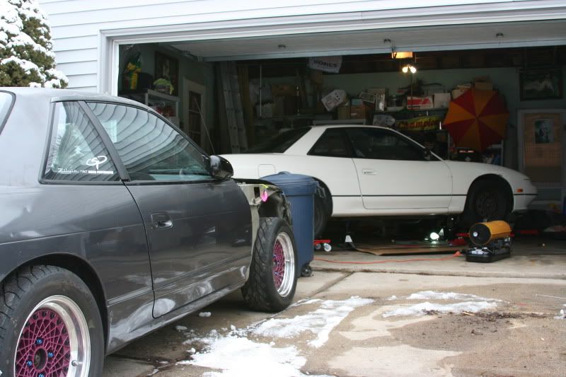

Well i'm sure a few people on here know the car/me. but for those who don't here is a QUICK view of what the car is.
Me and my girlfriend built her first 240 back in 2008, and then we picked this car up in November of 2010 and built this one.
We were going to do paint and body work on her old coupe but got some prices of $4000-$6000 to do it. and i thought let's see if we can find a cleaner shel, And this is what i found.
Car was in North Carolina. An Lady bought the car new in 1989 drove it a few thousand miles, and developed cancer she then ended up dieing, her family took the car and drove it once in a while then donated it to the family church for an up coming auction. The car sold to a guy in November 2010 He brought the car home his wife was pissed cause he went there to buy a motorcycle so she made him sell it. He posted the car on Craigslist, and that morning i found it. Next day money was sent via paypal. and a week later car was delivered to Milwaukee.
1989 Nissan 240sx Coupe SE (fully loaded) 5speed, heads up display, full power, sunroof,active sound,etc. 19,5XX when we got it. Which makes it the lowest mileage S13 240sx that is "publicly" known. I've heard rumors of 10,000 and 15,000 mile ones but no one has provided pictures or info.
When we got the car.
Shortly after. (During the build) December 2010-June 2011.
Radiator support replaced due to old radiator leaking and rotting old one out (same with battery tray)
Had a caged welded in at the same time too.
Started working to get the silvia front end on.
Motor went in.
Got the oil, trans and intercooler all rigged up.
Getting closer
Some interior work.
