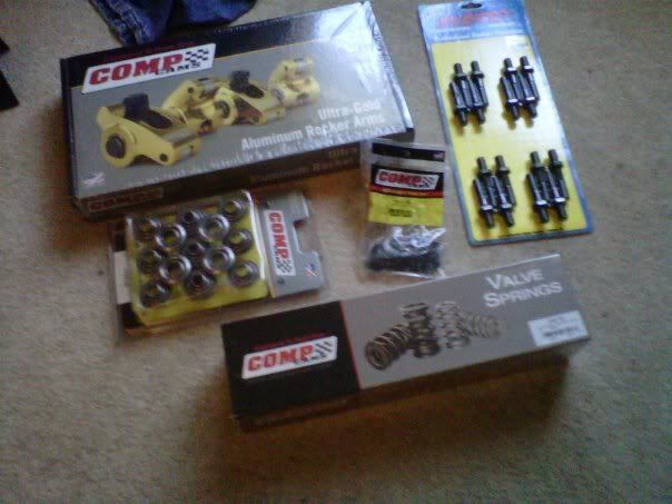

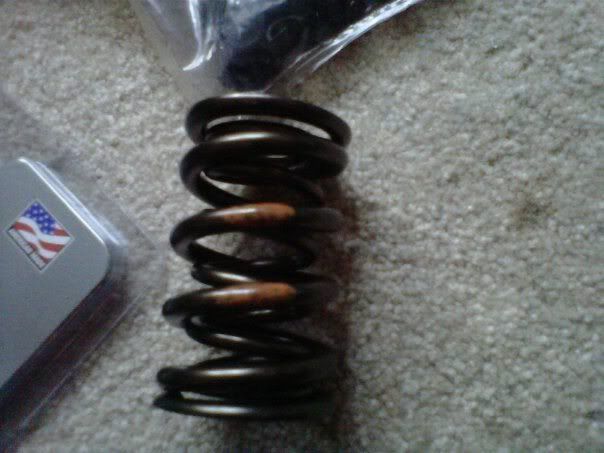

PostSubject: Re: .   . Icon_minitimeThu Feb 02, 2012 4:59 pm
Also I made a minor mistake, motor is closer to 12:1 than 11:1. shouldn't be an issue
Also they sent 1.72 rockers not 1.7. Also not a biggie. Just a little more lift and duration

PostSubject: Re: .   . Icon_minitimeFri Feb 03, 2012 12:14 am
should be fine if your running e85
. Empty
PostSubject: Re: .   . Icon_minitimeFri Feb 03, 2012 12:44 am
I know its not much but be wary about the increased lift. I'm sure you have measured depth and all so no worry of pistons slapping, but still slight changes in geometry do increase issues with wear, especially when dealing with the lift you are playing with at this time.
PS kudos for stepping up retainers, those comp ones are a nice peace of mind item!
. Empty
PostSubject: Re: .   . Icon_minitimeFri Feb 03, 2012 12:47 am
I wouldn't think keepers would go for 24 bucks! lol They are the 10 degree keeper and retainers.
We will check for ptv clearance for sure. lift is .688 instead of .680
