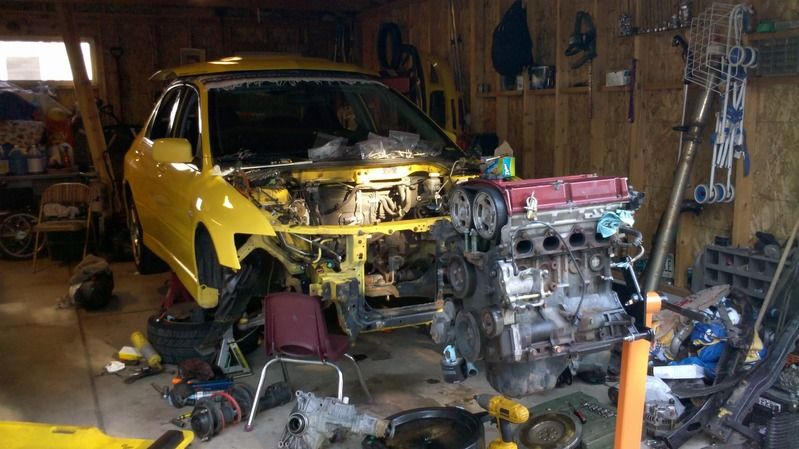

Around August, I took my car completely apart.
2.3L stoker 2011-09-05_17-07-01_285
The plan? 2.3L stoker pushing 500WHP on pump.

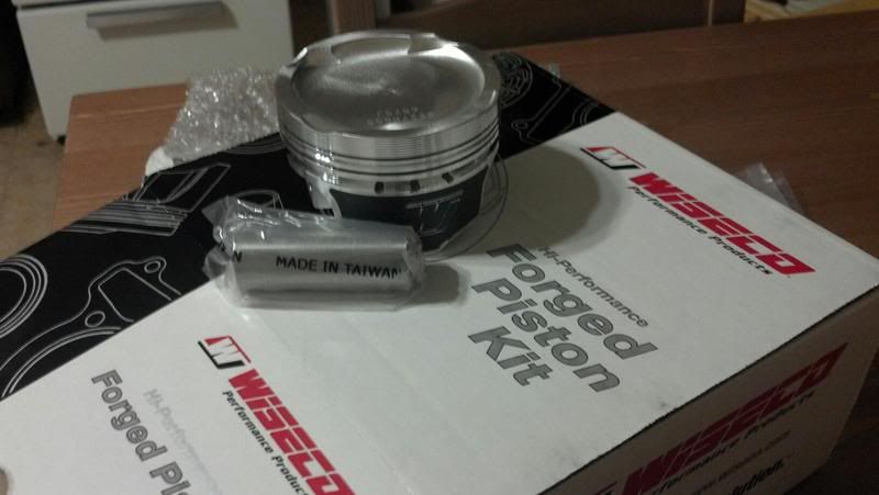

So far, I got Wiseco 1400HD pistons and Manley Turbo Tuff rods.

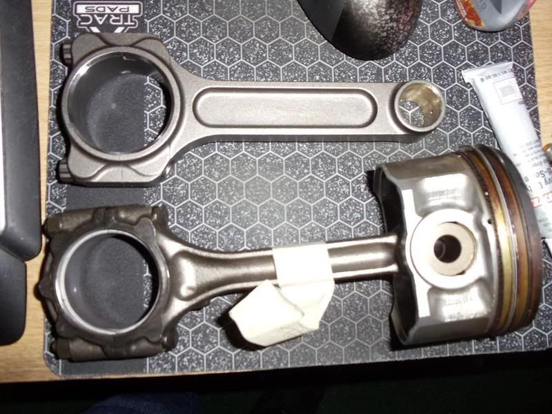

Turbo Tuff compared to the stock rods.

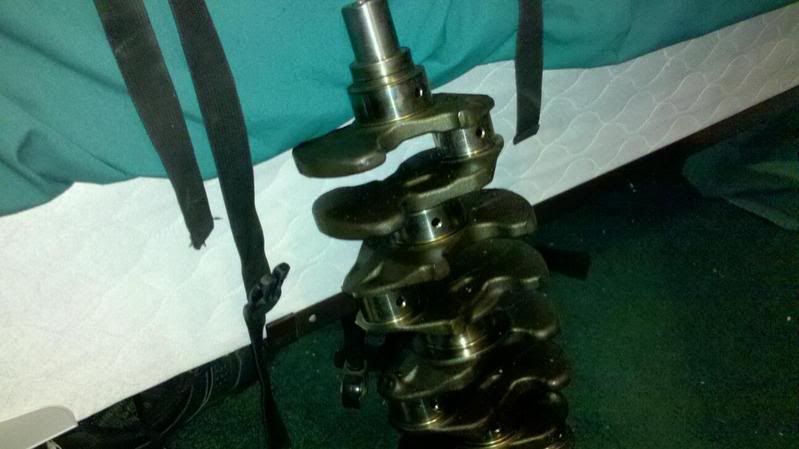

And of course, the most important thing for a stoker, the 4G64 crank.

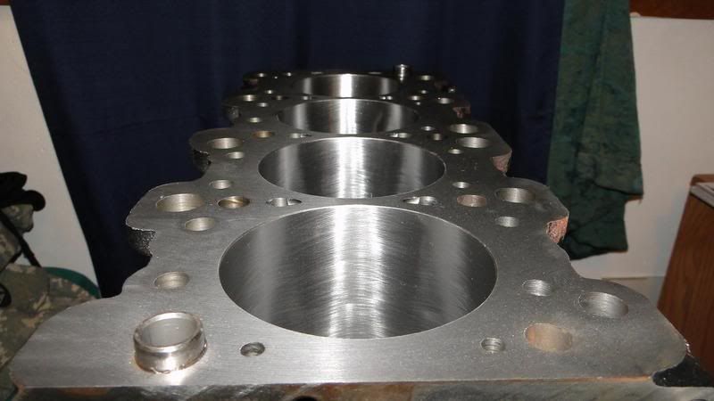

Now that I got the main things for the shortblock, it's time to get it machine. Bored .020" over, decked, and then honed. Also got the crank balanced checked and polished.

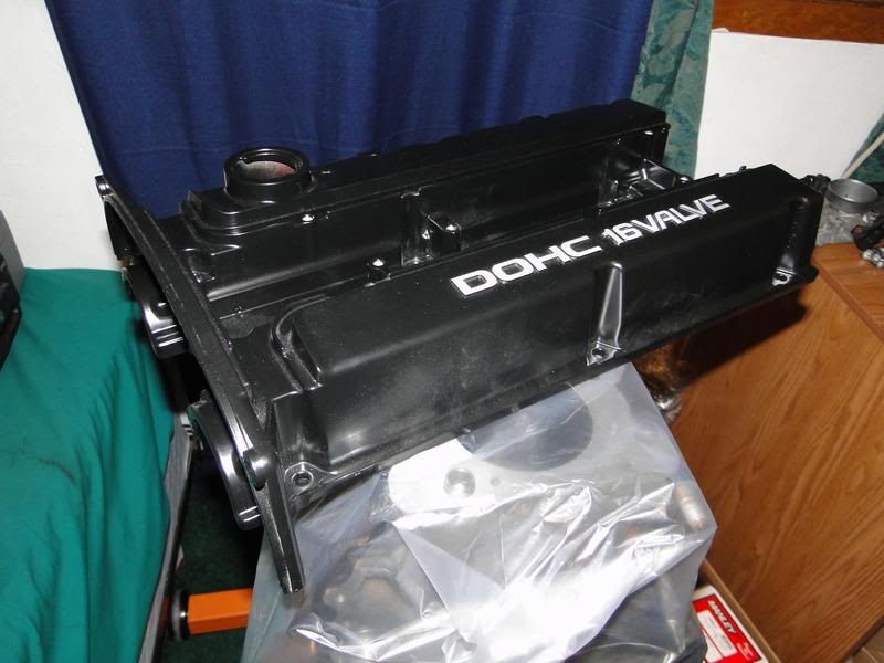

And just got my valve cover back from powder coating yesterday. So far, so good.

PostSubject: Re: 2.3L stoker   2.3L stoker Icon_minitimeThu Feb 02, 2012 2:39 pm
That's powder coat? Looks like spray paint.

PostSubject: Re: 2.3L stoker   2.3L stoker Icon_minitimeThu Feb 02, 2012 6:20 pm
It's powdercoat. The camera and flash makes it look worse than what it is.

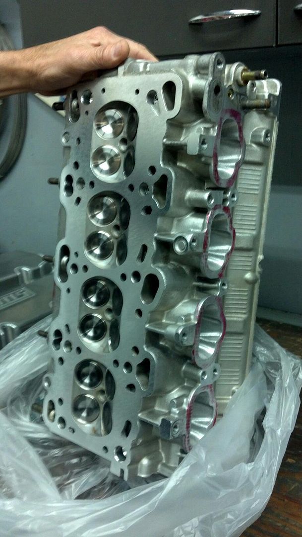

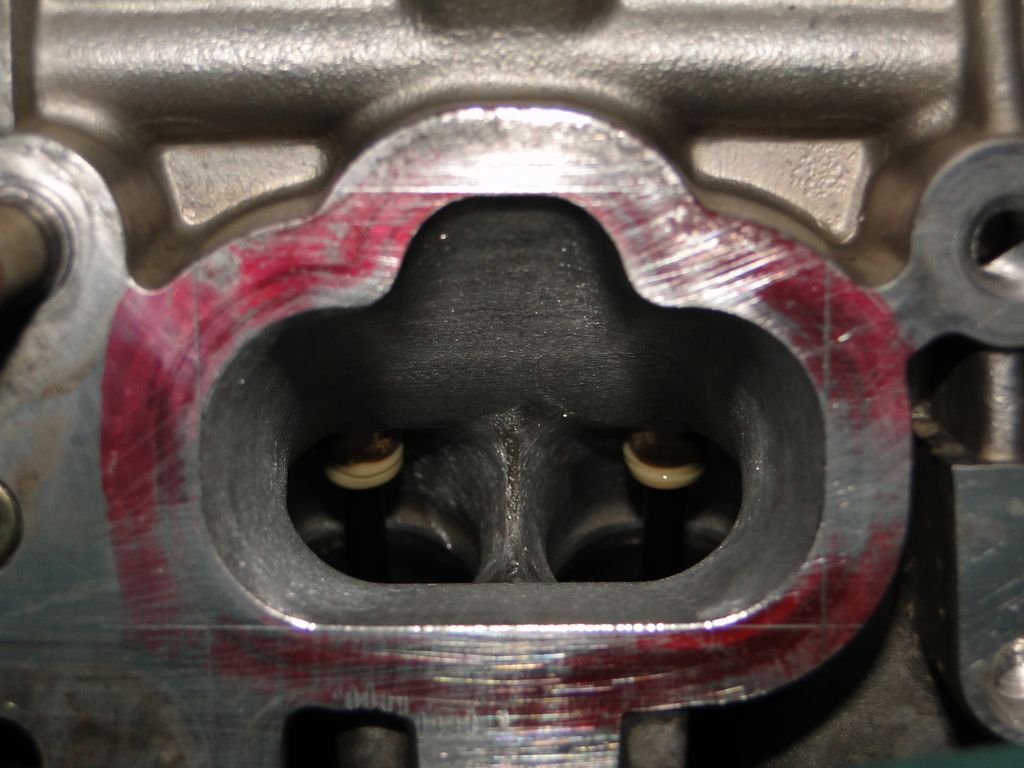

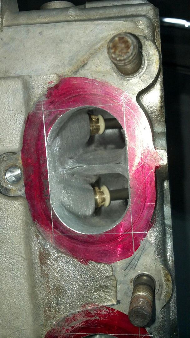

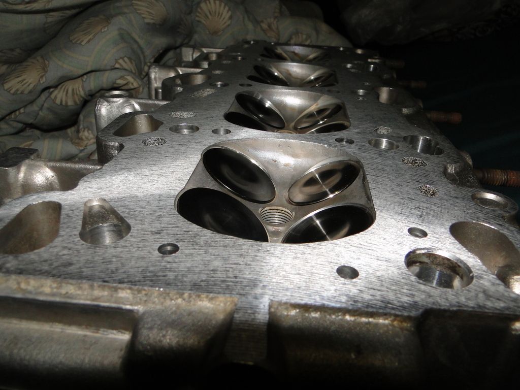

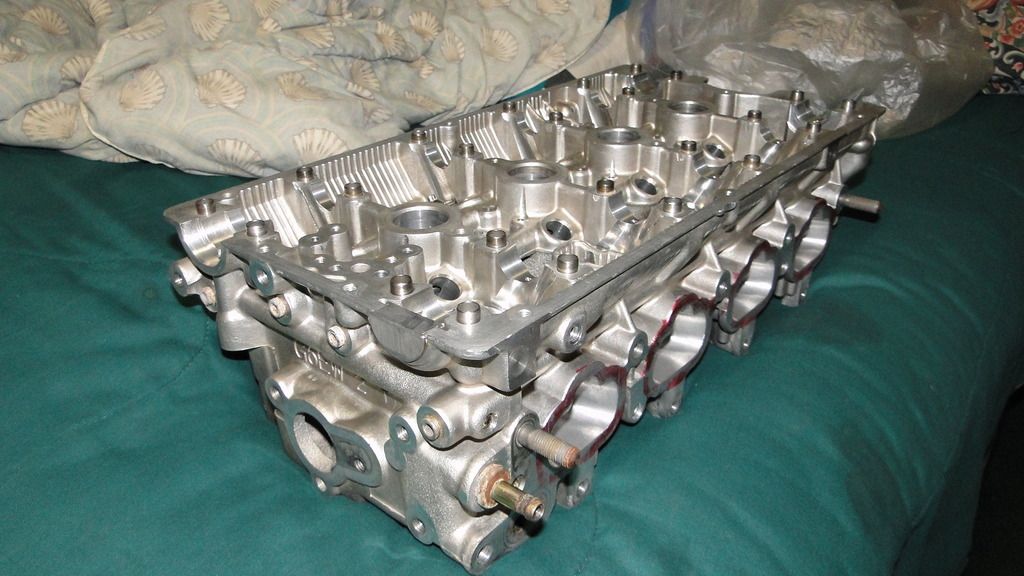

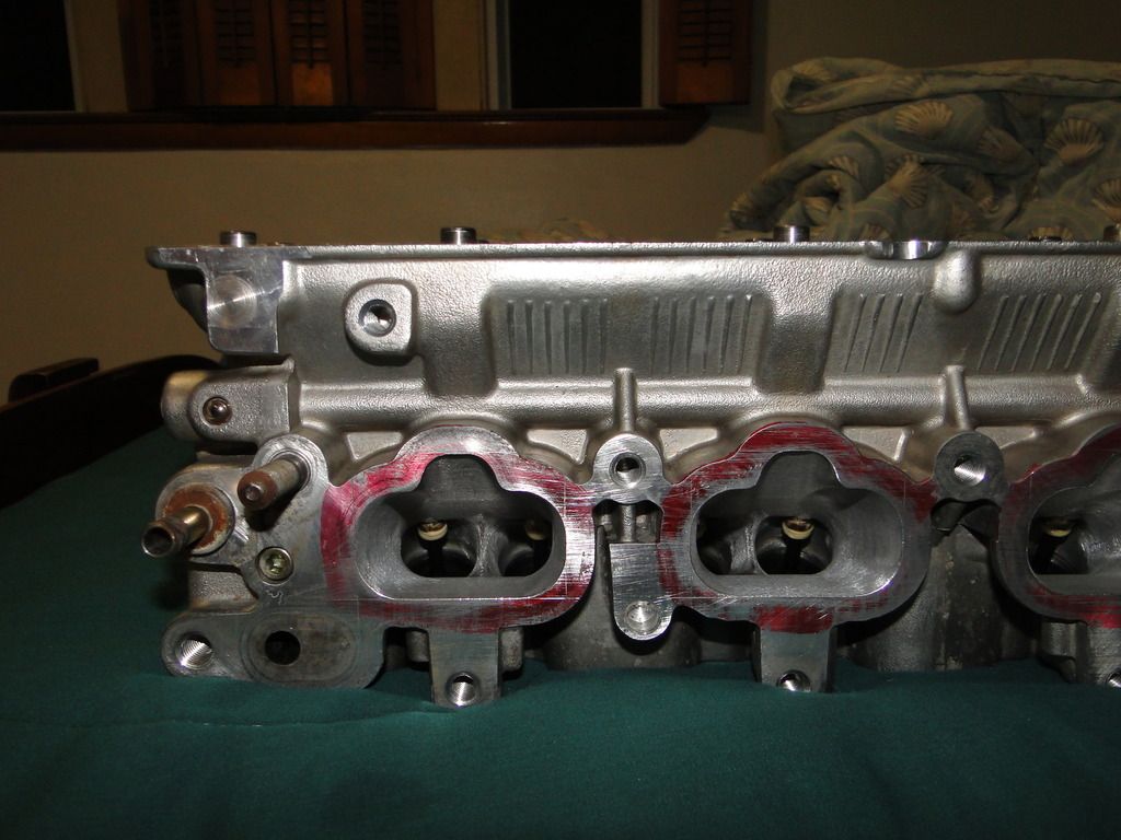

Finally got the head back from the machine shop. Very Happy
2.3L stoker DSC09030
Another shot of the bottom.
2.3L stoker DSC09034
Now this is the intake side.
2.3L stoker DSC09032
Closer shot.
2.3L stoker DSC09039
This was maybe one of the more expensive things on my list that I finally got done. Things should be moving a little faster after this.

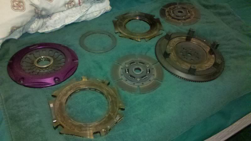

Just scored this twin disc for free thanks to a fellow EvoM member that was cleaning out his basement. Very Happy By far, the best deal I gotten in a while.
2.3L stoker 461642_3740968277258_1067705964_3428694_687540346_o

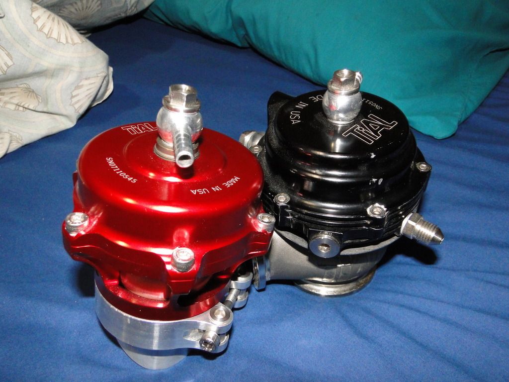

Some Tial's. 50mm Q BOV and a 44mm wastegate. As for color matching, whatever. Got both for a great deal.

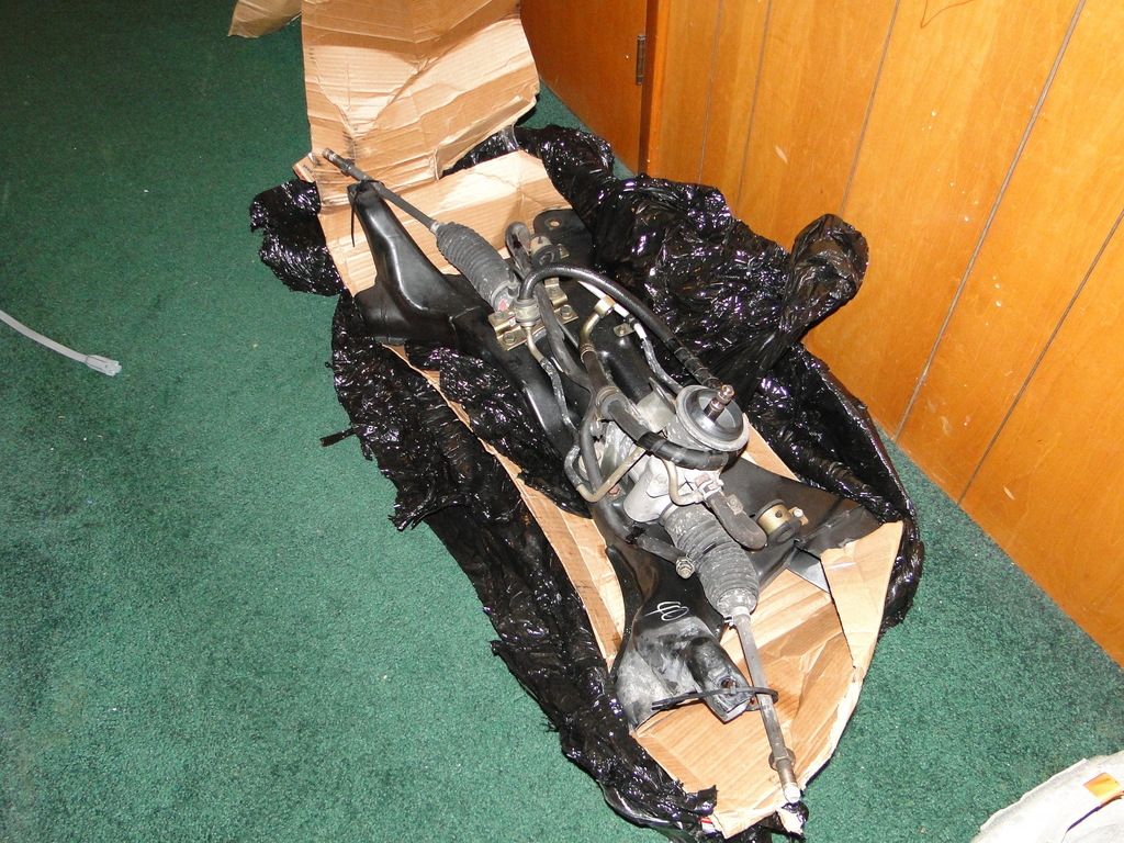

My current front subframe is all fucked up with rust and a seized bolt that will not move so the control arm and subframe are just stuck there. I've decided to say fuck it, I'm just going to cut up the subframe and the bolt to save the control arm and order new bolts. In the mean time, I ordered a used subframe from a donor Evo in Florida and it just came in the mail. All I can say is holy fuck. No rust anywhere to be found on this thing. Also came with a steering rack, which I didn't really need but wanted to replace anyways so it's a win-win situation for me.

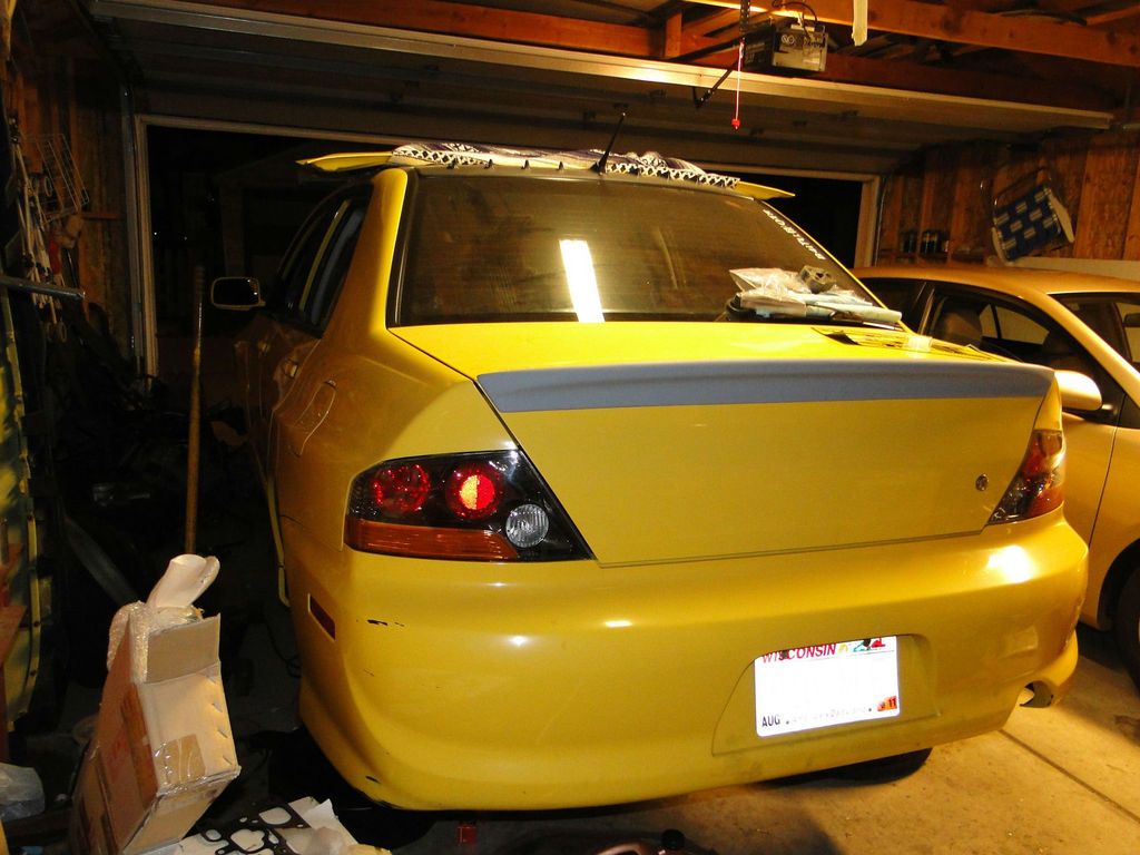

Last thing I got wasn't mailed to me but given to me from a friend. He had this lip laying around, wanting to put it on his car but he sold the car before we could paint it and slap it on. I was planning on putting the park bench back on the trunk but now, I don't know.
What do you guys think? Wing or this lip?

Nice build, I am really interested to see where this goes. But go with the lip, everyone and their mom has the bench wing and the lip look way cleaner! JMO.
2.3L stoker Empty
PostSubject: Re: 2.3L stoker   2.3L stoker Icon_minitimeWed Aug 08, 2012 9:02 am
I like the lip a lot too, do it.

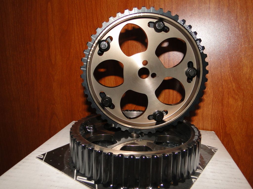

Out of all the cam gears for the Evo, this is by far the best looking one and maybe even the highest quality one you can find. Shit even came with ARP studs to lock the cam timing.

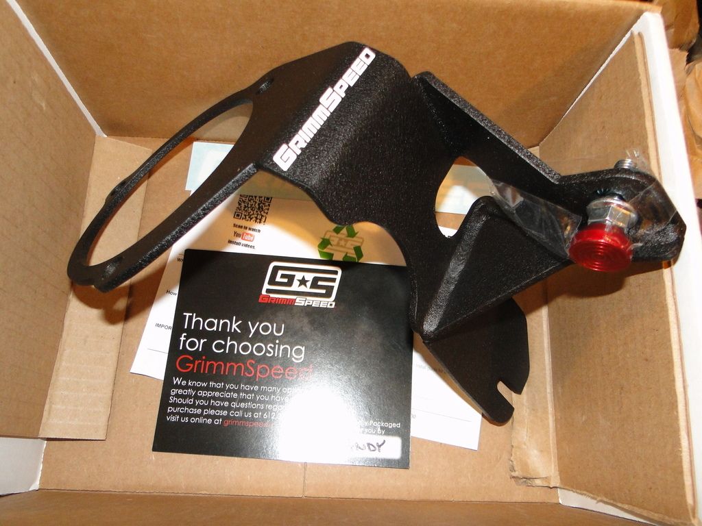

This one, I decided to get on a group buy. WAS going to use it on a friend's car but we decided to go to the car show instead. Maybe next time, I'll be able to test thing thing out.
2.3L stoker DSC09108
What it's supposed to do.
2.3L stoker GSBrace400x300

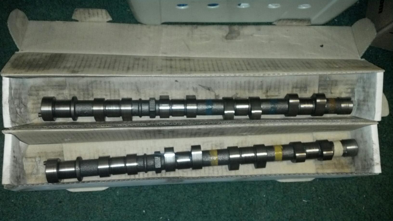

GSC S2 cams
Buschur 65mm ported throttle body (no pics)
-6AN valve cover fittings (no pics)
2.3L stoker 415361_4189632613586_1858871378_o

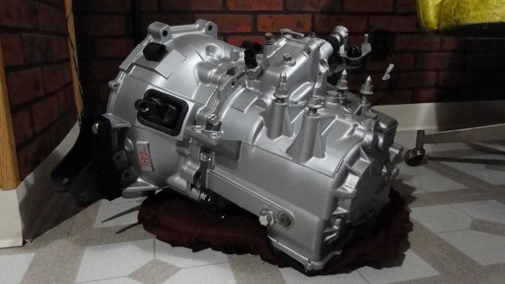

Now for a big update. Finally got my trans. Just fully built and ready for a lot of launching. Very Happy
TMZ Stage 2 built
Shotpeen all the gears
Final drive is now 4.0 (from 4.529:1), making the rest of the gears longer. 1st now goes up to 45mph (before, 40mph), 2nd gear 68mph (60mph), 3rd gear 94mph (83mph), etc. Cruising at 70mph, RPM is now at 2500RPM instead of 3000RPM in 5th gear, so it'll save me some gas. And with my turbo choice, the redline will also be changed to 7500RPM to make the most out of it and more mph in all the gears (1st will be 48mph, 2nd 72mph, etc)
Tim is the man to get your trans built. Beautiful work. Can't help but thank him a lot for his patience with me on my trans.
2.3L stoker 680418_4514765141696_1026839380_o
