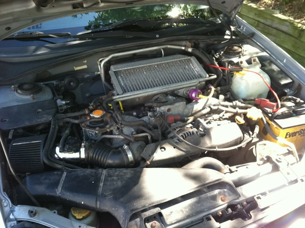

So today i bought and installed a intake filter along with the adapter for the maf plug.
I have a TurboXS bov and a bosal 3" spt catback exhaust.
Thing sounds like a bat out of hell. cheers
Will i be fine without a cobb tune? (keep in mind i have a apexi safc, not the best for the wrx but i heard you can mess with the afr''s with that)
Air fuel is usually at 14.xx on the hks turbo timer, and the air/flow is at a steady 1.0-1.1 at idle.
So yeah, am i still in the green? No goofy idle or anything.

I wouldn't be beating on it unless you feel like picking parts of your engine off of the road. Sell the safc and use that money for an open source tune. Shouldn't cost more than 200 bucks

14.xx under boost is VERY lean. Get that car tuned asap.

11.7 or richer on pumpgas
