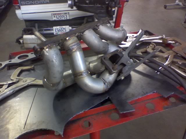

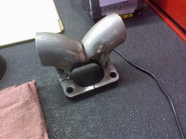

customer came in with one of those bad ass turbo xs manifols fallin apart.
so i was slicin up some schedule 10 stainless today
did the downpipe @ a year ago...
more to come...
PostSubject: Re: workin on a honda   Thu Apr 08, 2010 10:42 pm
TurboXS...... yeah. Even their 2.3T manifolds crack like hell.
Most people add extra bracing right out of the box..... and even then LOL.
Age : 43
PostSubject: Re: workin on a honda   Thu Apr 08, 2010 10:53 pm
i bet i welded that fucker up for him three times before he gave in on doing it the right way

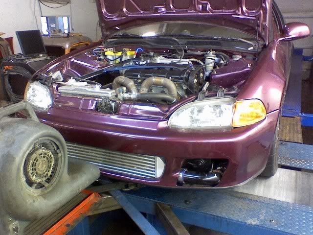

PostSubject: Re: workin on a honda   Sat Apr 10, 2010 2:07 am
not much but today...

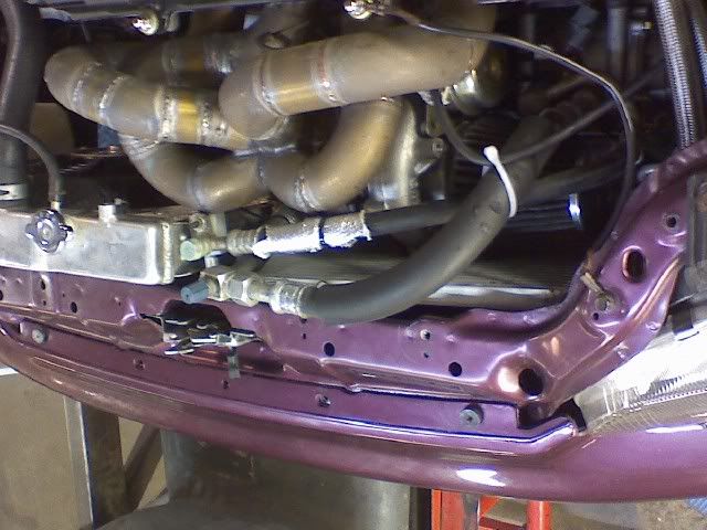

PostSubject: Re: workin on a honda   Wed Apr 14, 2010 10:53 am
lil progress this morning

PostSubject: Re: workin on a honda   Wed Apr 14, 2010 10:09 pm
The material they make those sweet ebay manifolds outta is junk, bracing or not they never seem to last lol . Nice looking piece nate.

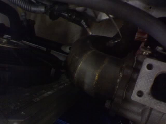

PostSubject: Re: workin on a honda   Thu Apr 15, 2010 12:52 am

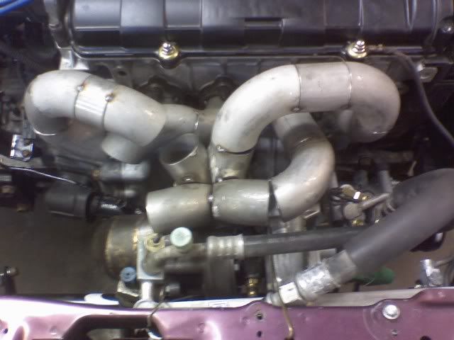

PostSubject: Re: workin on a honda   Mon Apr 26, 2010 2:15 pm
all done

dont know yet, the 2 bar map that was supposed to be installed by another shop is completely f'd so we just switched back to the stock one, will be limited to 10 or so psi. hoping to have some #'s before the end of the day...
update, customers previous mechanic had also made a wastegate actuator extension which was not holding the wastegate closed=no boost. was pretty hard to diagnose too since his boost gauge was 3psi off on the posative side and the map wasnt reading accurately all day. more/better updates tomorrow.
