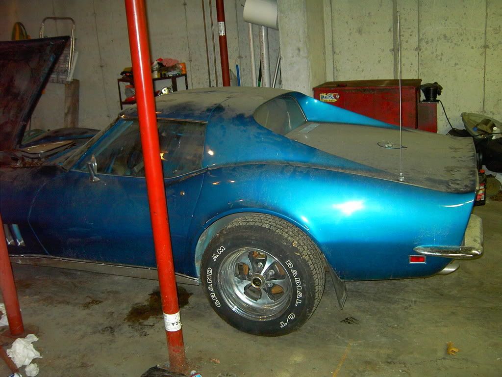

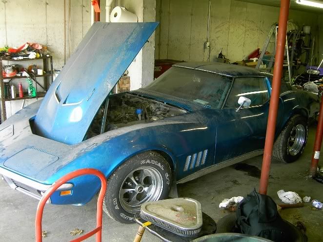

so i bought this
it was a family friends and sat in the guys shop for 10 years. when I bought it it had a 396 with the tri-power and a 4 speed. It took me two weeks to get it running took it out and it ran very poorly had to do some tuning got it running well and beat on it for about two weeks before I broke one of the outer axles then came the modding.

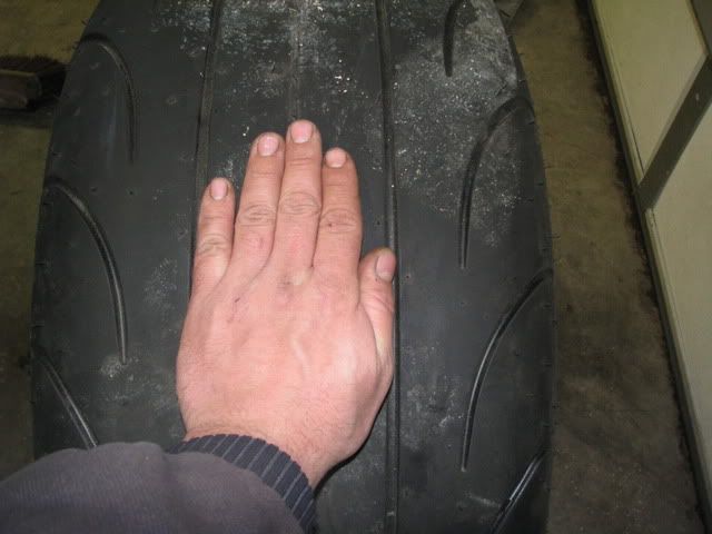

mounted up some tires
these are 325/50/15 drag radials these are BFG's the other set i have are M/T's

Here is the new tires

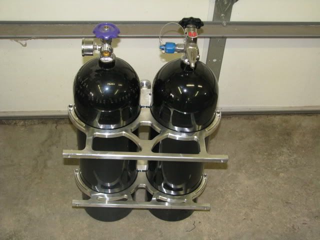

and what is going behind the seat
