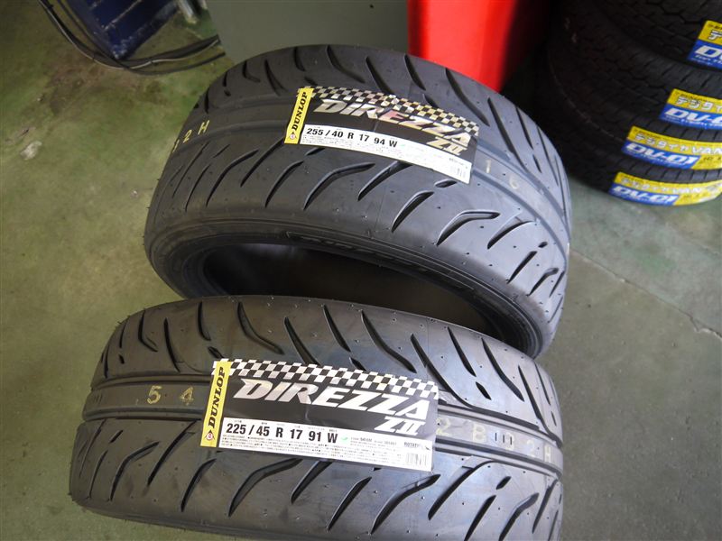

Next: New wheels were desperately needed. got these off a local 3/S member in Millwaukee for $100
FWD N/A, stock and slow, to AWD Twin Turbo and....1000awhp? 1098044_682278241800457_251118860_n
going from a 16X7 with 215/55 all season, to a 17x8.5 with some nice sticky 255/40 Dunlop Direzza Z2's
FWD N/A, stock and slow, to AWD Twin Turbo and....1000awhp? P1
(ones in picture are 225's I know)
These tires are great, even in the rain, the car hooks, even used them a little in the snow by accident, they weren't terrible.

I'll probably buy a pair of wheels to slap some street radials on for street foreplay...I really want to play with some of the faster cars up in Madison this spring/summer...I was up there last summer with my red car and no one was really interested sadly Sad
