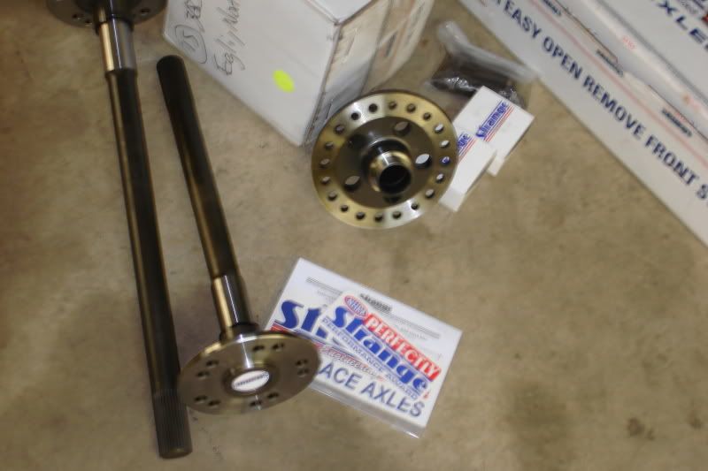

ma70tt Legit
Posts : 1372 Join date : 2010-01-26 Age : 49 Location : Madison
| Subject: Re: fuel rails showed up monday/finally put /em on today! Thu Jun 23, 2011 1:30 am | |
| i honetly dont think it will make a bit of difference for what i want to do this year (6-700whp). but next year it will really make sense when my goals are twice that with a forged/billet 427 stroker motor and both turbos compressor housings at least 20mm bigger in dia. | |

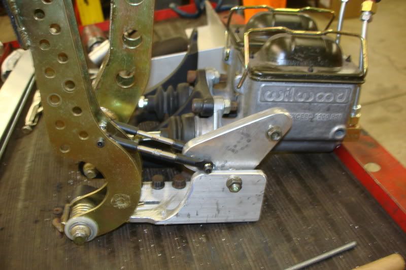

ma70tt Legit
| Subject: Re: fuel rails showed up monday/finally put /em on today! Thu Jul 28, 2011 12:36 am | |
| my dad came down for the day an knocked this shit out throttle controls at the pedal. the big thing here was getting the masters set up w./the geometry an all... an the coil mounts he made are nice passenger side but theyre both equally delicious. he also made the top intercooler/hood latch bracket, did the turbo feed/oil pess. block an a few other things today... brad terminated the front lights so now its down to fuel pumps, fans, etc.... | |
| Subject: Re: fuel rails showed up monday/finally put /em on today! Thu Jul 28, 2011 12:43 am | |
| Wow, that does look good!! Could you explain the coils Nate? It would appear that each cylinder gets it's own coil? Is this correct? Do you mount them away from engine for reduced heat? It looks really nice, just wondering if it has mechanical purpose besides astetics
Mike | |
ma70tt Legit
| Subject: Re: fuel rails showed up monday/finally put /em on today! Thu Jul 28, 2011 12:53 am | |
| yep, every cylinder on pretty much any ls motor had a cnp (coil near plug). well on this the turbo manifold sweep up an forward so the stock valve cover location was suspect for obvious reasons. so ye, we moved them to the firewall to get away from the heat. in moving them the stock valve cover bracket assy. is terrible so my ol man cam up w the aforementioned solution on the fly today... i think they look titties they will get the msd 8.8 superconductor treatment soon | |
ma70tt Legit
| Subject: Re: fuel rails showed up monday/finally put /em on today! Thu Jul 28, 2011 12:57 am | |
| fyi those pics are shit. ill take some more tomorrow/when you see all the adjustability he engineered into it its ridiculous. an you really have to come out an operate it! its so smooth its stupid. | |
